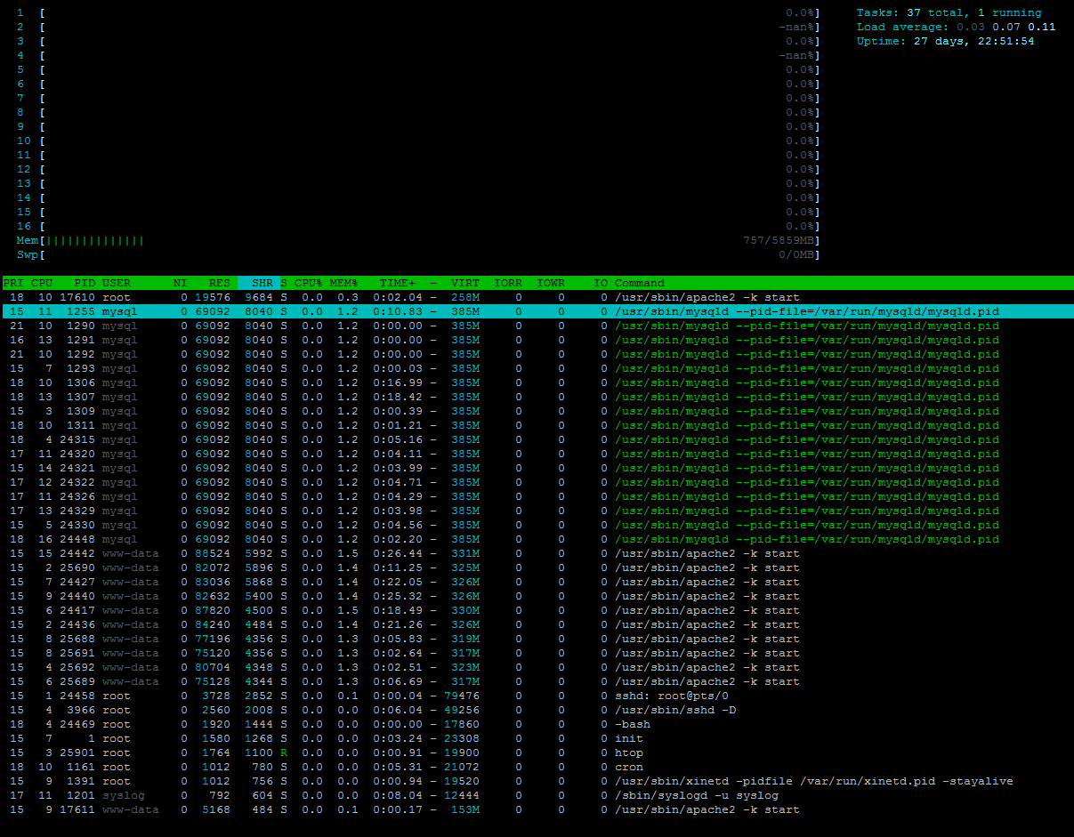

mikeaag Posted December 8, 2011 Share Posted December 8, 2011 Hi all, Hoping someone can help me with a problem im having. Im currently running a drupal based website, which has been coded by someone else. Its hugely inefficient, doing anywhere from 300-1100 database queries and using around 90mb of ram for each page load. Needless to say, our server takes a beating when more than 1 person is on it. In fact, it only takes about 15 people on the site at the same time to bring down the server. I know this is a software issue, but we are currently trying to make the situation better by configuring the server a bit. Here are some of the things i think would be beneficial, but dont know how to implement: limit the number of apache and mysql processes When i look at HTOP, it says 0/0mb for SWP. Does this mean i dont have a swap file set up? how do i check? Also, i would like to be able to implement something similar to twitter's fail whale. The site is currently hosted on a VPS, with 3GB guaranteed RAM and 3GB burstable RAM. Processing power doesnt seem to be an issue. The server is running Ubuntu 10.04 LTS. Any help on this matter would be greatly appreciated. If more info is need, just let me know :D Thanks in advance Mike Link to comment https://www.neowin.net/forum/topic/1043813-limit-apache-and-mysql-processes-and-ram-use/ Share on other sites More sharing options...

mikeaag Posted December 8, 2011 Author Share Posted December 8, 2011 This could be a misconfiguration of PHP if your site is coded in PHP. Sometimes the amount of PHP requests are being limited and therefore once PHP can't take no more your website will appear offline to other users. You have plenty of memory for a website to hold many, many, many users with the right configuration. If you have lots of users, have you considered compiling your website in Facebooks open source HipHop software? I can tell you right now your cpu usage on the server will be cut more than half. Also another option to look at is to use nginx (www.nginx.com) It uses very very little memory, you could even run your site with 512Mb memory with nginx or even less. I think limiting the amount of processes mysql and apache can make will be pointless, MySQL service only runs once on your server unless you have multiple mysql instances setup. If you need any help I will need your current PHP, MySQL and Apache configuration files posted. Matt. Hi Matt, Thanks for your quick reply. I have attached a print screen of HTOP from the server so you can see how many processes are running currently with no one on the site. From the screen shot you can see that there are multiple MySQL processes and multiple apache2 processes as well. I've seen HipHop before, but not looked too much into it. I'll have a bit more of a read to see if its possible to use. Have you used it before? is it easy to set up? I only have SSH access to the server, and im a complete beginner when it comes to linux commands :D Finally, if you could direct me to how i can get the those configuration files, i'd be more than happy to provide them for you Thanks again, Mike Link to comment https://www.neowin.net/forum/topic/1043813-limit-apache-and-mysql-processes-and-ram-use/#findComment-594505525 Share on other sites More sharing options...
