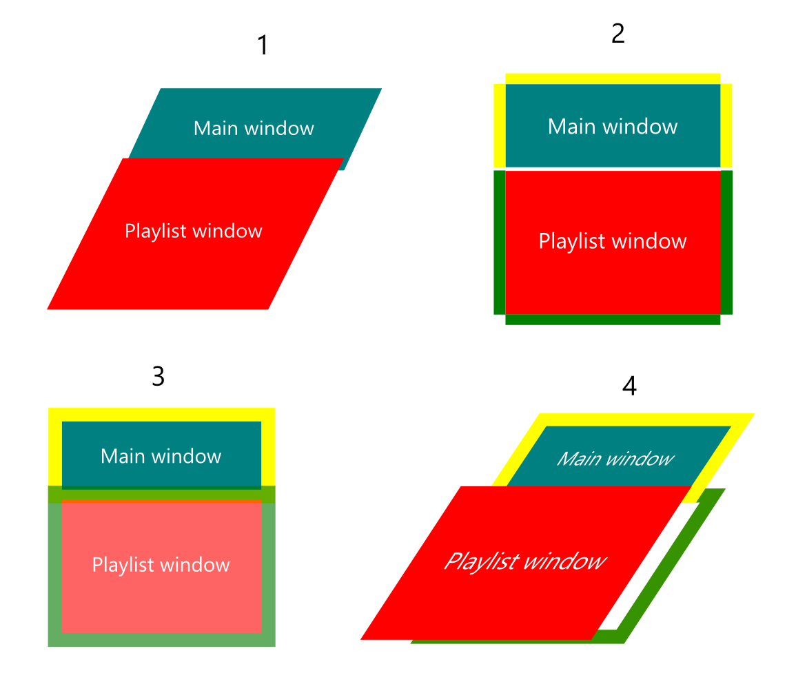

I was wondering when the first complaint would come in. That's a result of removing custom shadow and glow. It might come back at some point, but right now there is no easy way to do it.
Regression: due to issues with how the Micro and Nano player playlist was rendered, I had to go back to using
  a single window. That has as consequence that the playlist can only be shown downwards. Sorry about that people.
I still think it was awesome the way it was... I had no complaints about it.
I understand your dissapointment, I am too. And with this post I'm not trying to make you agree
with my choices. My choices are not always what I want myself, but more what the tools allow me to do.
You say you liked how the playlist was. Remember that I see more than just that. I see its stinking, ugly,
unreliable inner workings and potential for breakage. I'll explain shortly. Please consider the attached
picture.
Situation 1:
Users want a playlist that opens in 2 directions (top and bottom). To do so, the playlist needs to
become a separate window. The separate window needs to be synchronized with the main window. Otherwise
this happens: it appears in the alt-tab menu, it doesn't minimize when the main window minimizes,
it doesn't move together with the main window.
Solution: make the main window the "owner" of the playlist window.
Side effect: the owner is positioned UNDER the owned window automatically. No way around that.
So far so good. I did that and added no shadow to the playlist window (if you can remember that).
Situation 2:
Users wanted a shadow under the playlist window. Ok, with the custom glow/shadow I had going a while back
that was achievable. I made sure the common edge didn't have a shadow. No overlap happens.
Situation 3:
Users wanted the default windows shadow. Ok, I removed the custom shadow and restored the window shadow.
Damn, a problem occurs: one cannot just remove one edge of the windows shadow and overlap occurs.
Even worse: the amount of overlap is different on Windows 7,8 and 10 because the shadow size is different.
Even more worse: the size of the overlap changes depending on whether the main window or the playlist window
is clicked. I had to think out of the box.
Situation 4:
This is the situation that I built, to achieve what you like so much: 3 layers.
Bottom layer: playlist shadow (this is basically a transparent window with just the shadow)
Middle layer: the main window
Top layer: the playlist window
The trick is to keep the shadow at the bottom of everything, and to keep the playlist on top of the rest.
Because if the shadow ever gets over the playlist window, it wouldn't be clickable (there would be an
invisible film over it). Sounds easy! I isn't...
There is no z-index thingy for window... So to get the right order I had to do something like this
every time any window is clicked, moved,...:
Shadow.Topmost = true
Shadow.Topmost = false
MainWindow.Topmost = true
MainWindow.Topmost = false
Playlist.Topmost = true
Playlist.Topmost = false
Because of all this messing with the Topmost property of windows, there was no way to even force the
main window to be topmost anymore. It was a nice try, but it was unreliable.
