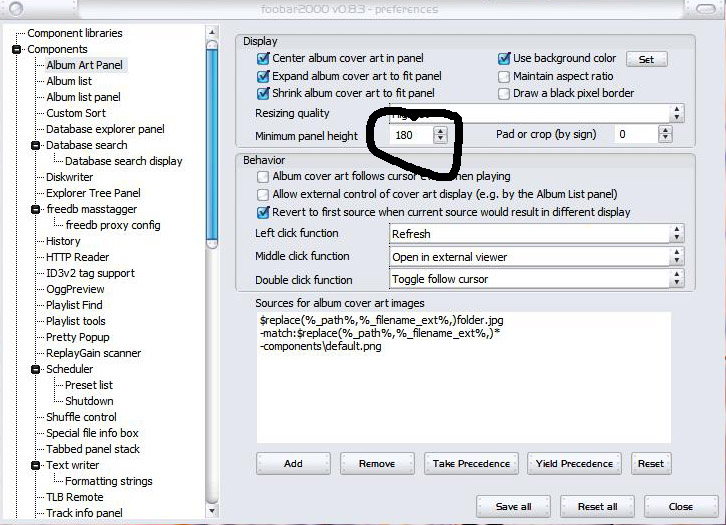

greatestfall Posted June 7, 2005 Share Posted June 7, 2005 everything looks almost okay now, but i can't seem to resize the album art panel.. :huh: Link to comment Share on other sites More sharing options...
Phrozty Posted June 8, 2005 Share Posted June 8, 2005 Here is where you change the height for album art ;) Link to comment Share on other sites More sharing options...
