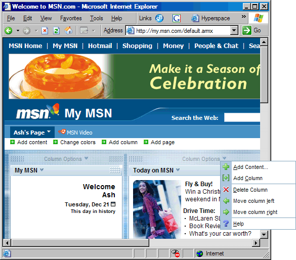

Question
Take a look at the attached pic. It shows a dHTML menu that appears when the ?Column Options? title was clicked. However, unlike normal dHTML menus, this one sits on top of the HTML Window area; look at it again, the menu appears outside of the browser window!!!
My question How is this done?

&lt;script id="menuData" type="text/xml" src="https://my.msn.com/en-us/mymenuxml.armx"></script>
This is the line (so much as you can call it a line) that refers to the content of the menus, which is in XML format. (It's like <menus><menu><item /><item /><item /></menu></menus>.)
The menu code itself is JavaScript, it seems like. It shows how to implement a generic menu and then it gets the content itself from the XML file.
I think that's how it works anyway.

It's a floating something alright! We have seen floating things before BUT this one is different! This one can float outside the barriers of the browser window!!! Look at the menu on my screen shot above.
Surely there are some JS/CSS/dHTML experts here that can shed some light on to this phenomenon.

For Heaven's sake.
I formatted this and added some spacing and junk. I commented only the stuff that's immediately obvious, because i have to go to work like 10 minutes ago. Like i said, it gets all the actual content from the XML file; this is just the code for the skeleton.
