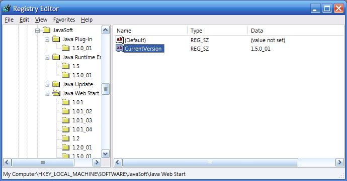

So if it is the correct version, then why Autopatcher did not detect it?
585373261[/snapback]

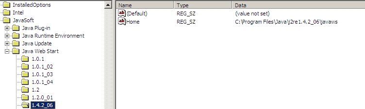

I assume you are referring to the detection of J2SE Runtime Environment 5.0? The module detection system is designed to look for programs that it has installed. Each module leaves a trace entry in the registry. When AP loads subsequent times, it will scan the registry for pre-defined entries. If it finds it, it considers it installed; unless you specify /noregcheck in the startup parameter. Since you or someone else installed the other version of Java, AP does not see it installed via it's detection method.
In this case, the "sunjava.amc" looks for the following info:
HKLM\Software\JavaSoft\Java Web Start\CurrentVersion
value="1.4.2_06"
If that key is present in your registry, AP will detect it as installed.
value="1.4.2_06"
585373345[/snapback]
^like this?
