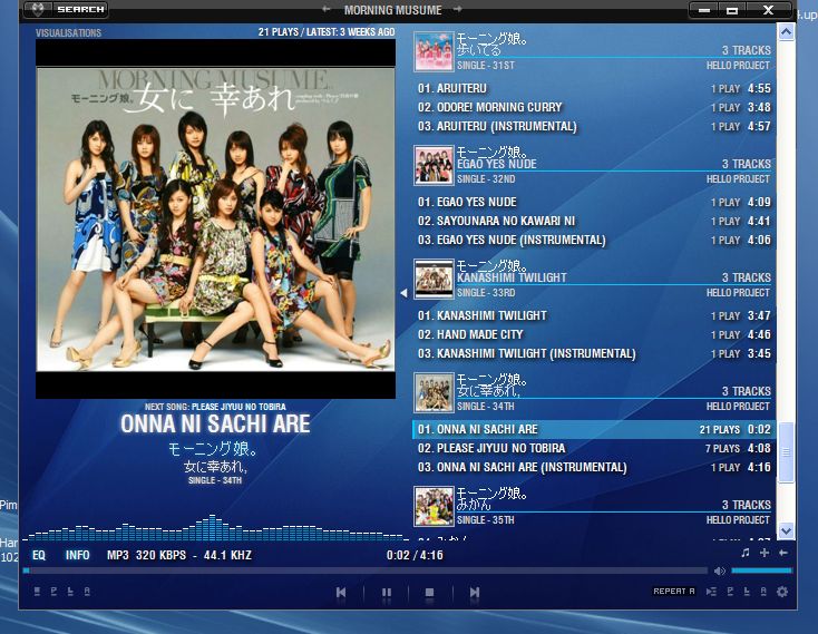

Hello, I have modded FooAvA a bit to get that clear glass effect on Vista. I just have one small problem:
I have a small square hole on each individual cover art on the right playlist panel which I have been unable to fix, attached is a screenshot of what I am talking about.
@JJJ
Here is what you need to do to properly display your album art:
Right click on the album art portion of the playlist, go to settings, make sure you are in Group Display:
	$drawrect(1,8,37,37,brushcolor-null pencolor-180-180-180)
	$imageabs2(33,33,,,,,3,10,images\fooAVA\art5.png,nokeepaspect)
	$imageabs2(33,33,,,,,3,10,$replace(%path%,%filename_ext%,*.gif),NOKEEPASPECT)
	$imageabs2(33,33,,,,,3,10,$replace(%path%,%filename_ext%,*.png),NOKEEPASPECT)
	$imageabs2(33,33,,,,,3,10,$replace(%path%,%filename_ext%,*.jpg),NOKEEPASPECT)
	$imageabs2(33,33,,,,,3,10,$replace(%path%,%filename_ext%,*.bmp),NOKEEPASPECT)
	$imageabs2(33,33,,,,,3,10,$replace(%path%,%filename_ext%,*cover*.*),NOKEEPASPECT)
	$imageabs2(33,33,,,,,3,10,$replace(%path%,%filename_ext%,*folder*.*),NOKEEPASPECT)
	$imageabs2(34,34,,,,,3,10,images\fooAVA\artoverlay.png,)
	$puts(xoffset,40)
Replace the current chunk with that, it adds .bmp support and also adds the additional search for cover/folder images.
Edited by xyhec
First of all, try to to get rid of all blur effects, e.g.:
$font($get(fontAVA),9,glow-20-20-20glowexpand-0 glowalpha-100,255-255-255)
change it to:
$font($get(fontAVA),9,,255-255-255)
