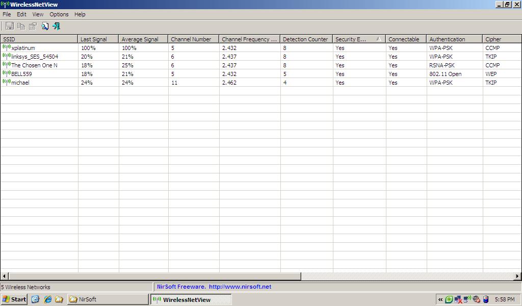

xplatinum Posted May 17, 2009 Author Share Posted May 17, 2009 (edited) Virtorio: 2 wireless laptops connect to the router (Linksys WRT160N with DD-WRT) and have no issues. They are currently turned off to troubleshoot the problem more efficiently. Spyder: Very good idea. I know there are at least 3 other SSIDs showing up when connecting with the laptops (they do no show up on the 360, however). You might want to take a look at this freeware from Nirsoft. standalone executable, very simple with lots of info. http://www.nirsoft.net/utils/wireless_network_view.html Thanks for help guys, I'll try what spyder suggested. edit: here what's showing up; mine is ovbiously the first one on top. Edited May 17, 2009 by xplatinum Link to comment https://www.neowin.net/forum/topic/773224-xbox-360-wireless-adapter-slow/#findComment-591003784 Share on other sites More sharing options...
Olemus Posted May 18, 2009 Share Posted May 18, 2009 thats your problem, the channel your using is very crowded, you should always leave at least 1 gap between your channel and someone else. E.g there on channel 6 you would not use 5 or 7 but 8 and 4 would be acceptable, change the channel on your router to something at least 1 channel away from everyone else and see if it solves the problem. Link to comment https://www.neowin.net/forum/topic/773224-xbox-360-wireless-adapter-slow/#findComment-591005792 Share on other sites More sharing options...
xplatinum Posted May 18, 2009 Author Share Posted May 18, 2009 LonelyCooler said: thats your problem, the channel your using is very crowded, you should always leave at least 1 gap between your channel and someone else. E.g there on channel 6 you would not use 5 or 7 but 8 and 4 would be acceptable, change the channel on your router to something at least 1 channel away from everyone else and see if it solves the problem. I'm on channel.1 right now and I am experiencing the same problems. Might be an issue with my version of DD-WRT. Link to comment https://www.neowin.net/forum/topic/773224-xbox-360-wireless-adapter-slow/#findComment-591005932 Share on other sites More sharing options...
