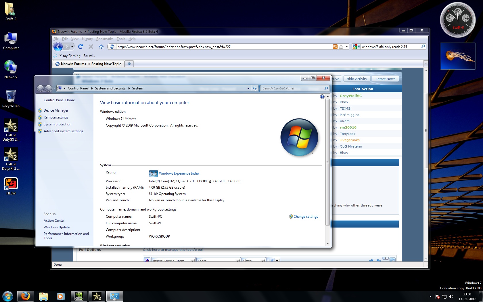

Swift-R Posted May 17, 2009 Share Posted May 17, 2009 I have just installed Windows 7 x64 RC and I noticed it is only reading 2.75GB of my 4GB of ram... How is this possible!? Link to comment https://www.neowin.net/forum/topic/773260-windows-7-x64-only-reads-275gb-ram/ Share on other sites More sharing options...
Eric Veteran Posted May 17, 2009 Veteran Share Posted May 17, 2009 Naughty motherboard? Can you post your system specs? It could be allocated to video if you're using integrated graphics or one of the ATI/nVidia cards that use shared system memory. Link to comment https://www.neowin.net/forum/topic/773260-windows-7-x64-only-reads-275gb-ram/#findComment-591004232 Share on other sites More sharing options...

hdood Posted May 18, 2009 Share Posted May 18, 2009 Have you seen if there is an option in your BIOS to remap the memory addresses that clash with hardware like graphics cards? On some motherboards you have to turn it on to use all your RAM as part of the first 4GB is reserved for hardware. Link to comment https://www.neowin.net/forum/topic/773260-windows-7-x64-only-reads-275gb-ram/#findComment-591004250 Share on other sites More sharing options...
Eric Veteran Posted May 18, 2009 Veteran Share Posted May 18, 2009 Thiefyo said: it`s reading 4 ... if u cant see wheel put some glases.. it say`s only 2.75 is usable probably the rest it`s used by the sistem:) Be nice. And with x64, it should never tell you (xxx available). There is no 4GB limit, so system resources can be mapped at +4GB leaving all RAM usable. The only time x64 should show reserved memory if is something else is actually using it, like Intel's GMA video chipset or bargain editions of other video adapters. Link to comment https://www.neowin.net/forum/topic/773260-windows-7-x64-only-reads-275gb-ram/#findComment-591004292 Share on other sites More sharing options...
Swift-R Posted May 18, 2009 Author Share Posted May 18, 2009 My specs: Asus P5Q Core 2 Quad Q6600 XFX GeForce 9800GX2 250GB WD Sata 16mb buffer -> using 25,4GB partition for W7 Creative X-Fi XtremeMusic I'll try to find that remap thing in bios. Link to comment https://www.neowin.net/forum/topic/773260-windows-7-x64-only-reads-275gb-ram/#findComment-591004344 Share on other sites More sharing options...
hdood Posted May 18, 2009 Share Posted May 18, 2009 I have a P5B, and I had to enable it in the chipset configuration section, might be the same on the P5Q. It's just called "enable memory remapping feature" or something like that on the P5B. Link to comment https://www.neowin.net/forum/topic/773260-windows-7-x64-only-reads-275gb-ram/#findComment-591004354 Share on other sites More sharing options...
