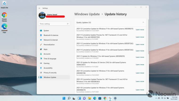

- Click on Update History, this will show you a history of the updates installed on your configuration, you can click on "Learn more" to do exactly that for each update

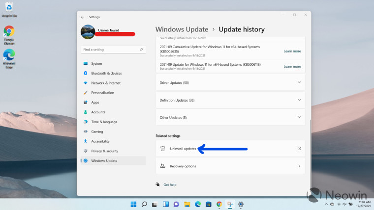

- Scroll down to the Related settings section, where you will find the Uninstall updates option. Click on it

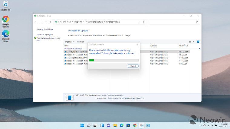

- This will open the legacy Control Panel, which will show you a list of all the updates currently installed on your machine. Double click any update that you have verified as problematic, this will show a dialog box asking you if you want to uninstall the update. Click on Yes
- While the update is being uninstalled, you'll be shown a progress bar for a couple of minutes, wait for this to complete
- Once the progress bar has filled up, you'll be asked to restart your PC now or later to complete the uninstall process

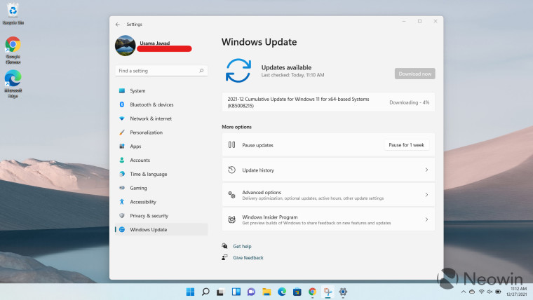

- Later, if you feel that you made a mistake or still need the update, you can simply click Check for updates in Windows Update again. If it is still being offered for your configuration, you can just install it as usual, as can be seen in the screenshot below:
