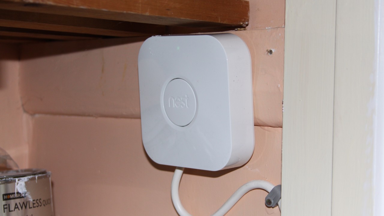

The first thing that gets setup is the heat link which connects up to your boiler and the electrics coming from it. Basically our installer just removed our old one and connected it up to the new one in about 4-5 minutes. During this time he had plugged in the actual Nest Thermostat to get it up and running as quickly as possible.
Once the Head Link was attached to our cupboard wall, he then came over and discussed where we would like our Nest Thermostat to be installed. This is where most of our discussions were made as we hadn’t a clue. Our old thermostat just sits on a shelf, he said the Nest is best suited at eye level on a wall.

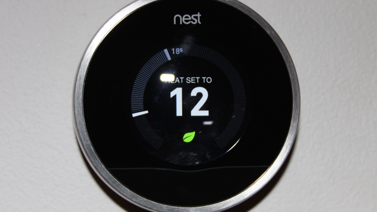

After the install it was time to get down to working out exactly what this thermostat can do. On the front of the nest is a display which comes on either when you walk by it (if you want it to) or when you press it. Once the display is on show you can see your current house temperature and the humidity level inside.
If you want to increase the temperature is your house all you need to do is to turn the outer dial of the Nest to the right, the temperature goes up in increments of .5 degrees. If you have air conditioning or any other cooling/heating system then you can also reduce the temperature too by turning it the other way.

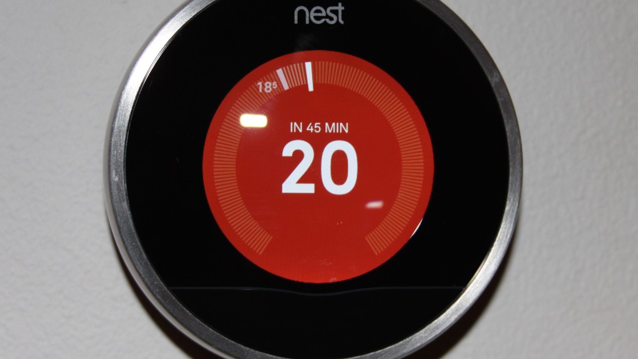

The Nest also has a feature called “True Radiant” this means that the Nest can learn how long it takes your house to heat up to the temperature you want it to be, so say at 8am you like it to be 20 degrees, the Nest will learn how long it takes your boiler to fire up and get the house to that exact temperature and make sure that at 8am it IS actually 20 degrees and not just slowly getting to it. The True Radiant feature actually learnt our system pretty quickly and was up and running in about 4 days and gets it spot on. The display on the Nest can even tell you the exact amount of time it will take to reach any temperature you set too.

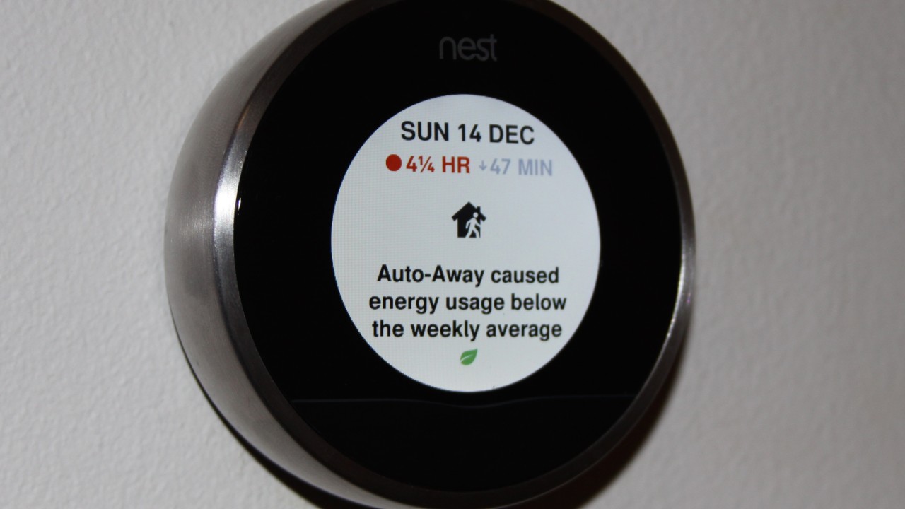

The Nest also features something called “Auto-Away” this lets the Nest turn itself down if it detects that you have left the house with the heating on. It took about a week for this feature to come into action and I have seen it work a couple of times when we have disappeared out with the heating on then returned home an hour or two later and see that our temperature has dropped a few degrees down from the setting we had, its a great feature and one that can make quite an energy saving.

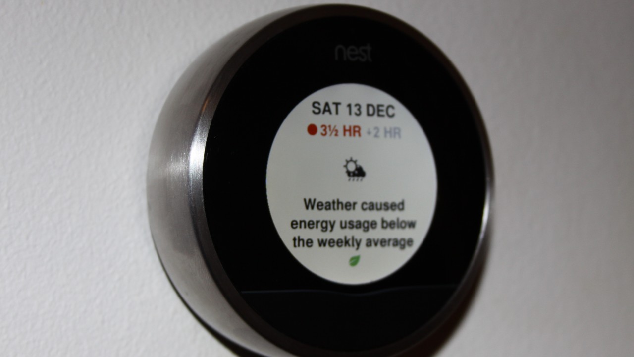

Finally we have the Energy History and Energy Reports which the Nest create for you. These reports help you see how the Nest has worked for you, it shows when you heating has been on, what temperature it was and how the weather and Auto-Away features have worked for you. Over the past couple of weeks we have checked them out and its interesting to see exactly how we have been using our heating.
