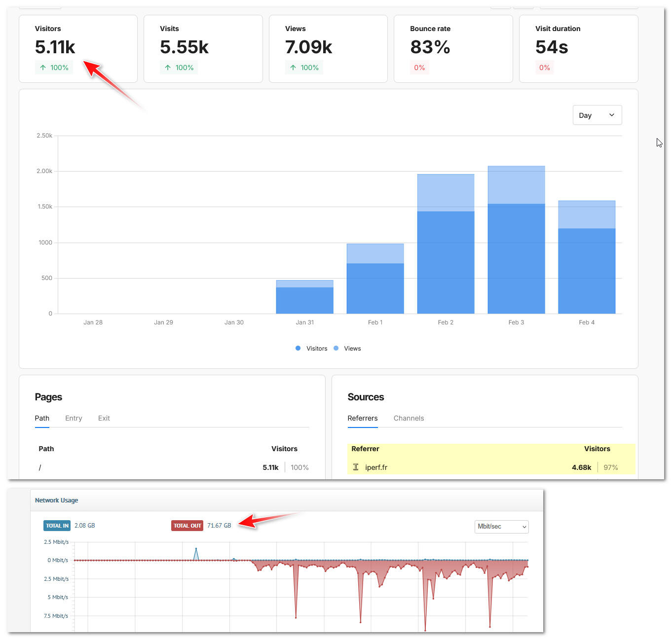

+BudMan MVC Posted March 7 Author MVC Share Posted March 7 I just downloaded quite a few different files from it.. let me look if I can see anything in the logs. edit: could you PM me your IP address.. I see some security errors, but not very many.. It supports both IPv4 and IPv6 - so send me both if you use IPv6.. But really the only issues I see is security related.. Example If you let me know time frame and your IP(s) I can look to see if anything in the server log. I don't see any issues in the access logs, man I was not aware so many people downloaded stuff from here Another example of some errors Lots of traffic from China, WTF Odd that number one file is older version 3.16 3.18 is number 9, with 9k some downloads. And then 3.11 has some 2k hits in the last 7 days.. That seems odd, I keep the old versions up as archive.. Didn't think people would still be downloading them edit: I just download multiple files without any issues using both edge and chrome as well my main firefox browser.. I can not find anything wrong on the site - and clearly it is seeing plenty of traffic and downloads. Looking through the logs.. WTF is chocolaty using this to grab installs from? [06/Mar/2025:01:25:11 -0800] "GET /iperf3.16_64.zip HTTP/1.1" 200 80982 "-" "chocolatey command line" But I am not seeing any issues.. But be happy to look through logs for your IP to see if something is off there.. Link to comment https://www.neowin.net/forum/topic/1234695-iperf-318-windows-build/page/6/#findComment-598971678 Share on other sites More sharing options...
